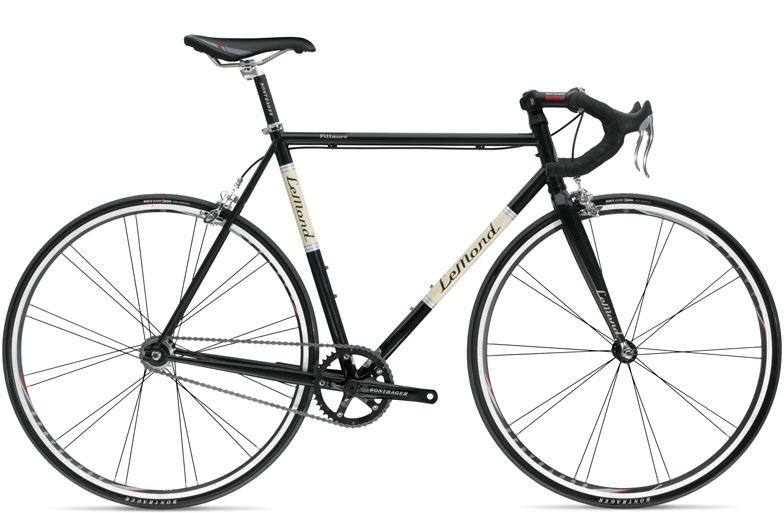

Jenson USA: LEMOND FILMORE bike '05
Nothing beats the simplicity of a fixed gear bicycle. Whether you use it on the track, for winter spin training, or just for errands, the Filmore will be a great addition to your cycling family. It's got a great True Temper OX Platinum frame, a Bontrager Race carbon fork, and a Bontrager Select Track wheelset with Dura-Ace® cog.
Fork: Bontrager Carbon
Front Der: N/A
Rear Der: N/A
Shifters: N/A
Brake Levers: N/A
Brakes: N/A
Cassette: Dura-Ace® 16T track cog
Chain: Shimano® HG73
Crankset: Bontrager Race Track, 44T
Bottom Bracket: Truvativ, ISIS
Headset: Slimstak, Direct Connect
Saddle: Bontrager Race Luxe
Seatpost: Bontrager Carbon
Handlebar: Bontrager Race Lite OS
Stem: Bontrager Race Lite OS
Tires: Bontrager Race Lite
Pedals: N/A
Wheelset: Bontrager Select, Track
1000 dollar

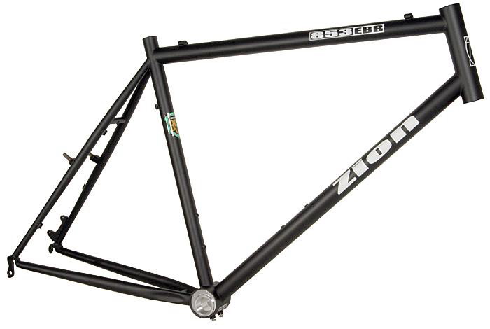

Jenson USA: ZION 853 EBB frame
300 dollar Feltöltött kép En akar ilyet :D
